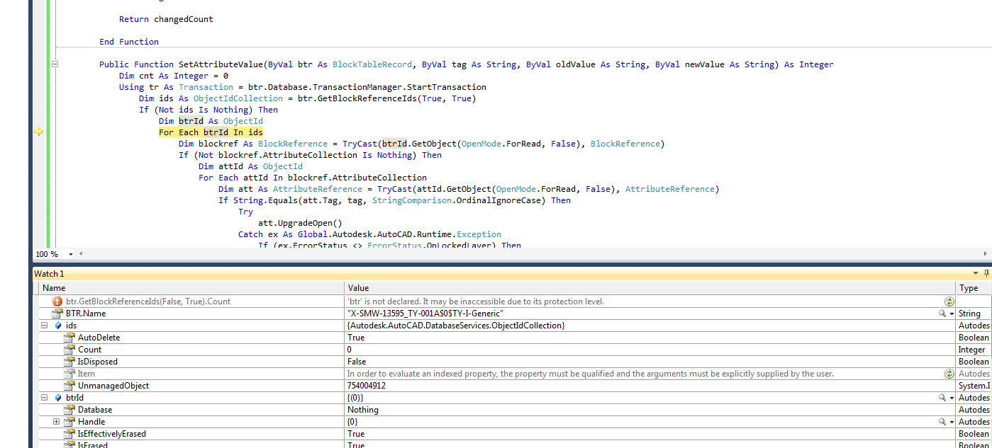

So I got the fiber issue with Autodesk worked out and now able to test the coding...
When I get to the function SetAttributeValue and set a break point...
Dim ids As ObjectIdCollection = btr.GetBlockReferenceIds(True, True)
If (Not ids Is Nothing) Then
            Dim btrId As ObjectId
            For Each btrId In ids
It just goes to Next.
It finds the block but does get any blockreferenceIds (please note image provided as attached)
Message 6 of 12
norman.yuan
So, if BlockTableRecord.GetBlockReferenceIds() returns a empty ObjectIdCollection, it means there is no BlockReference based on this block definition exists in this drawing; or if the block is dynamic block, then you need to find corresponding anonymous BlockTableRecords, then all the BlockReferences based on these anonymous blocktablerecord (as I mentioned in my previous reply. Is the block a Dynamic block?).
Norman Yuan
Drive CAD With Code
Message 7 of 12
Yes.  Sorry - just discovered it is a dynamic block.
Message 8 of 12
