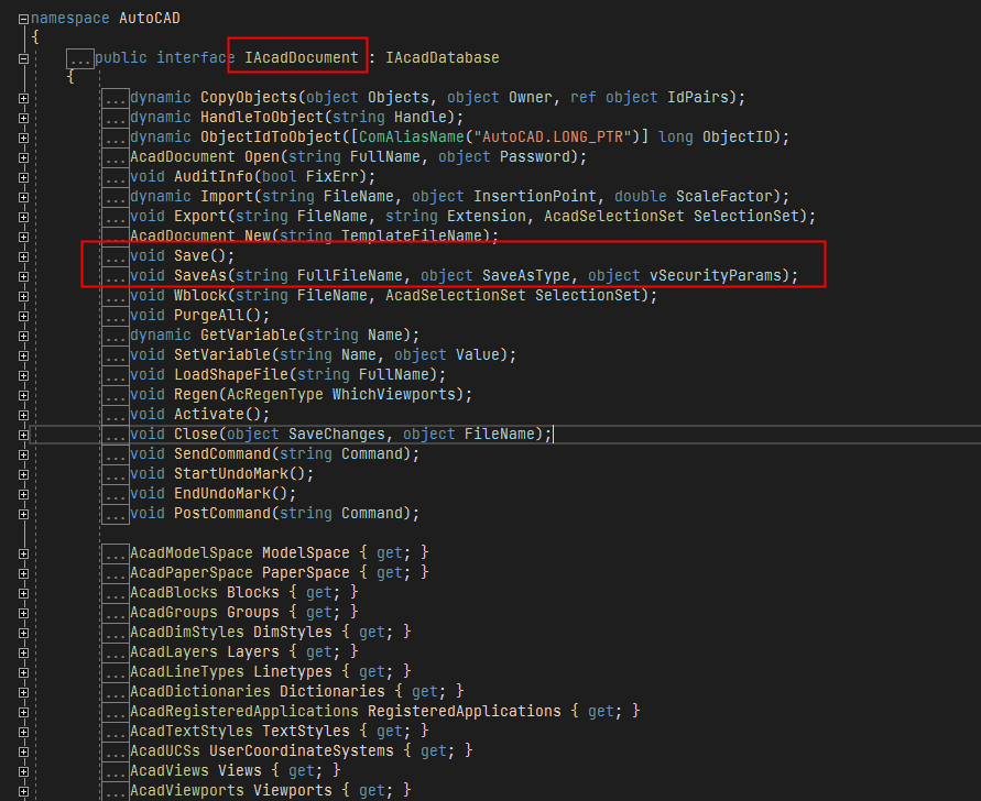

With the following code, can not bind xrefs,I don't know why?

Message 7 of 10
阿黄狗
Thank you for your answer, I just want to replicate that function in the picture;I wonder how autocad is implemented , use eTransmit and Bind Dwg Files94776762-FB10-468a-B935-C5FD9D88E60A.png

阿黄狗
but the NotificationHandler can only get database, the AcadDatabase can not save, only AcadDocument can save; so use database(AcadDatabase ) can not save the drawing;1313AF37-025B-42cb-B319-D92F29278F55.pngE4BDA31B-91D3-4bb2-A2B3-5C869AD94987.png
Message 10 of 10
daniel_cadext
So, somehow you need to get the .NET version of the database, which does have a saveas method.
ARX has a global function acdbActiveDatabaseArray, I don’t know if there’s a .NET equivalent.
