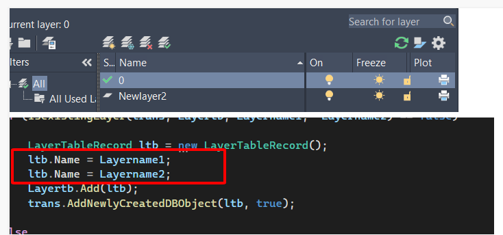

Hi all,
Recently i start to Learn C#.
I start with basic object is create "Name layer". So have some problem when i create multiple layer. It only appear a layer in layer table.In spite of i created two layer in my code.  You can see a snapshot below. Someone can help me fix this code
Thank you !!!

Hi @traiduong014969
You only use the Add method once. You need to Add each layer. Also, when you post code, please use the </> button to paste code to a special window. Please use the box in the upper left of the window to choose C# as the language format. Do not use images. See code below.
ltb.Name = "Name1";
Layertb.Add(ltb);
trans.AddNewlyCreatedDBOjbect(ltb, true);
ltb.Name = "Name2";
Layertb.Add(ltb);

traiduong014969
Thank for sussgestion, I have just test again code with your code. However, it only appear '' Layername2''  in layer box

Jeff_M
                    LayerTableRecord ltb = new LayerTableRecord();
                    ltb.Name = Layername1;
                    Layertb.Add(ltb);
                    trans.AddNewlyCreatedDBObject(ltb, true);
                    ltb = new LayerTableRecord(); //Add this line
                    ltb.Name = Layername2;
                    Layertb.Add(ltb);
Ed__Jobe
Sorry, I left out that you have to create a new LayerTableRecord for each layer. Also, you probably want to set the other properties of the layer besides just the Name, e.g. Color, Linetype, etc. After you get all the properties set, then you can Add the layer. If you are writing this code to add a bunch of layers to a dwg that doesn't match your template. A better method would be to open the template in a side database and just copy the layers to the current dwg.
