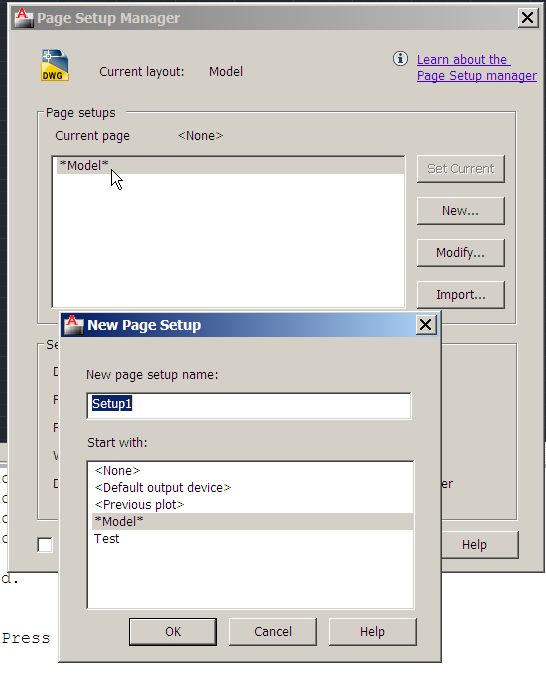

Hi Virupaksha,
Thank you so much for taking the time to respond to my question.
For your reference I attached my sample project solution stripped down to the bare essentials.
I've done the following.
Disable my Class2011Autocad from the registry from Autoloading.
I'm running Autocad 2011
E.208.0.0 (English Version 3)
My DLL's are: (I'm using the ones included in c:\ObjectARX 2011\inc)
AcDbMgd .NET 18.1.0.0
AcMgd .NET 18.1.0.0
I've set copy local to "FALSE"
I did notice that the DLL's in the (C:\Program Files\Autodesk\AutoCAD 2011)
AcDbMgd .NET 18.1.115.0
AcMgd  .Net  18.1.208.0
  1. Opended Autocad 2011.
  2. NETLOAD TestPlotCode.dll
  3. Typed showmsg -Success!
  4. then typed addmyplot -Command recognized
  5. then typed pagesetup
It doesn't show in the pagesetup manager. (See image 1)
But when I press new pagesetup it shows in the list of available options. (see image2)
As you can see.
It does work... but not intially. This is not the the way it is intended to work is it?
IMAGE 1
Then the pagesetup does show.
IMAGE 2
Then the pagesetup does show. (see image3)
When I click on layout 1 and then back at model tab.
Again thank you so much for looking into this problem!

Message 7 of 8
Virupaksha_aithal
Autodesk Support
Autodesk Support
Please accept my apologies… I missed very simple and basic step of adding the new plot setting to current “Transaction”.
<CommandMethod("AddMyPlot")> _
            Public Sub AddPlotSetting_test()
        Dim CurrentDatabase As Database = Application.DocumentManager.MdiActiveDocument.Database
        Using currentTransaction As Transaction = CurrentDatabase.TransactionManager.StartTransaction
            Dim pl As PlotSettings = New PlotSettings(True)
            Dim layoutId As ObjectId = LayoutManager.Current.GetLayoutId(LayoutManager.Current.CurrentLayout)
            Dim activeLyt As Layout = currentTransaction.GetObject(layoutId, OpenMode.ForRead)
            pl.CopyFrom(activeLyt)
            pl.PlotSettingsName = "Test"
            'set other setting
            Dim psv As PlotSettingsValidator = PlotSettingsValidator.Current
            psv.RefreshLists(pl)
            pl.AddToPlotSettingsDictionary(CurrentDatabase)
            currentTransaction.AddNewlyCreatedDBObject(pl, True)
            currentTransaction.Commit()
        End Using
    End Sub
Virupaksha Aithal KM
Developer Technical Services
Autodesk Developer Network
Message 8 of 8
Thank you so much Virupaksha!
That resolved the issue.
Being someone learning the Vb.NET object model from scratch and coming from VBA this is a life saver!
So for future reference those who have this problem
Don't forget.
