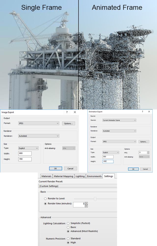

Does anyone know why there is such a difference in quality when rendering a single image as opposed to rendering frames from an animated sequence?
The left hand side of this image is rendered as a single file, the right hand side as a frame from an animation.
Both have the same render settings, defined from within the Autodesk Rendering window.

You have set render by time; 5 minutes on 1 frame will give better results than 5 minutes for multiple frames.  I recommend you don't render by time but by levels.  For both lighting and numeric precision on "High" you'll need at least 20 levels.  I normally recommend using "Standard" for numeric precision; you don't loose a whole lot and it reduces rendering time.
Also, render to PNG format.  JPEG format is "lossy", once compiled into an animation this can cause some banding and other artifacts.  Plus, it supports alpha-channel (transparency) for compositing.
Model looks good Smiley Happy

Thanks for the reply.
I have had more success rendering with levels, but the frame time on a single machine is too lengthy for my needs (it's a pity network rendering isn't supported).
I have the model exported into Max, so I'll do the animations there - I was just hoping to negate the need for export and import.

Much as I appreciated the reply from dgorsman, it didn't really answer my query as I still don't understand why in the single frame render the quality is so much better than in the sequence frame render when the settings are identical for both.
Any further light that can be shed on the matter would be greatly appreciated.

Hi WatsonAlan7507,
Thanks for your reply. Sure, I am happy to help you with some further details.
Dgorsman´s point was, if you use a rendering setting "rendering by time" and you set i.e. 5 minutes, your product will go ahead and start the rendering process and it finishes it after 5 minutes, giving you the results what ever it was able to achieve within these 5 minutes.
If in those 5 minutes it had the job to render one single frame only, you might get a fairly good result, however if you gave him the order to render an animation, which contains multiple frames in every single seconds in it, the program might not be ready with all the rendering work to be done. After the 5 minutes are over, it gives you it´s results anyways, but you may have to expect far worse quality as the program invested the same amount of effort into a lot more work to be done.
I hope this makes sense.
