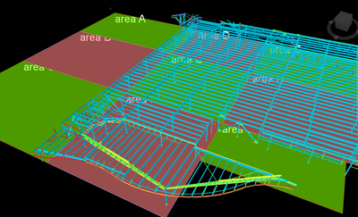

garylzimmer
I appreciate your continued help and find your screenshot very interesting!
I'm not using overlay mode in my example. I'm rendering in model context where everything is drawn at z=0.
In the first screenshots, I draw the text first, then the rectangles.
In this the next screenshots, I render the rectangles first, then the text.textsecondangle.PNGtextsecondtopdownpersp.PNG
The rectangles are so dark because I lowered their transparency to 20% but the text still doesn't show through.

Message 11 of 23
alexisDVJML
Nice concept you got there !
Looking at your first screenshot (reproduced below), I finally understand what you want to achieve and maybe the reason/explanation for your issue.
Your screenshot:
Looks like, please confirm, you use:
- Text2D(TextFontInfo fontInfo, string text, Point2D origin, int offsetX, int offsetY) for the text
- Rectangle(Point3D origin, Vector3D xVector, Vector3D yVector, bool filled) for the rect thus showing as a parallelogram at this angle
My understanding of the Rendering in Navisworks is:
- 3D methods, like Rectangle(Point3D origin...) render like the actaul 3D objects in the model,using clipping, culling etc
- 2D methods are actually Overlay methods withotu any depth per se
In addition, while not explicitly documented, I 'm assuming:
- 3D methods should be enclosed by BeginModelContext/EndModelContext (but most probably not needed if called from Render(View view, Graphics graphics) since this should be the current context)
- 2D methods should be enclosed by BeginWindowContext/EndWindowContext(but most probably not needed if called from OverlayRender(View aView, Graphics aGraphics) since this should be the current context)
Now back to your use case, I would guess:
- you do all the rendering in the Render(View aView, Graphics aGraphics) method
- you call alternatively Text2D and Rectangle(3D....)
Thus the things get messed up
If I understood correctly above, you do not need any trick to offset some part, instead you could try something like the following pseudo-code in Render(View aView, Graphics aGraphics:
BeginModelContext();
for (int i = 0; i != areasCount; i++)
    Rectangle(area[i].position...);
EndModelContext();
BeginWindowContext();
    Text2D(area[i].name...);
EndWindowContext();
Main Scientist, Full Stack Developer & When Time Permits Director of IDIGO ► On your marks, Set, Go

garylzimmer
Very close! Text2D is correct, but I'm using
Rectangle(Point2D, Point2D, Boolean) "Renders a 2D rectangle in the XY plane at the current Z depth."
in the screenshots. That's why I was wondering what "current Z depth" meant and how if possible I could change that.
I think the issue maybe because I'm drawing two objects on the same z-plane so it renders awkwardly. I think I may try to change to the 3d rectangle method that you mentioned, that way I can set the origin in a lower z coordinate than the text.
For the 3D version of the rectangle method, it mentions the origin of the rectangle. Is that located at a corner of the rectangle or the center of the rectangle? 3d vectors confuse me a bit.
