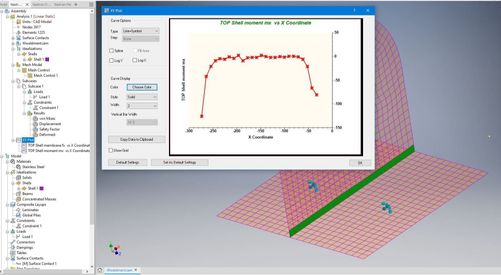

How do I get the units or display it?
Please refer below images:
BoltedBeam.jpg<== Moment XY Plot Unit?
BoltedBeam.jpg<== FX XY Plot Unit?

Hi @reymart.laranjo
This article (on knowledge.autodesk.com) refers to the contour plot. But since the units are not shown on the contour plot, that indicates that no conversion is occurring. So the units for the XY Plot are the same as for the contour plot.
See What are the units for shell membrane and moment results in Autodesk Nastran In-CAD.
