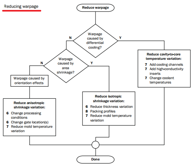

madhukeshwart
1. The first step is measuring how much the part has warped with the current processingm conditions. The results from the warpage analysis are compared to the tolerances for the part to determine if the part is acceptable or not. When the parts don't meet the tolerances, the warpage must be reduced.
Determine the Cause of Warpage, If the part warps more than the tolerance allows, the warpage must be reduced.
2.complex interaction of part geometry, material, and processing parameters that lead to warpage &warpage can be broken down to three main causes as discussed in including:
• Orientation effects• Area shrinkage effects• Differential cooling effects
Once these three main causes of the warpage can be determined, the warpage can be reduced.
3.Reducing the amount of warpage to get it below the tolerance involves addressing the primary cause of warpage . Fixing the primary cause of warpage can be done in many ways. The numbers beside possible ways to fix the warpage refer to steps numbered in
Often, reducing the amount of warpage is an iterative process. Several possible solutions could be found and evaluated to determine which one is most practical or economical. Many times it will take several iterations before the warpage is reduced enough.flow_charte02.png
