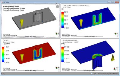

PascalGosset
About the voids, I mean holes insides the walls, like this one:
Is it possible to predict them? How? Witch result? What value?
By example in this case:
Many thanks for your replies.

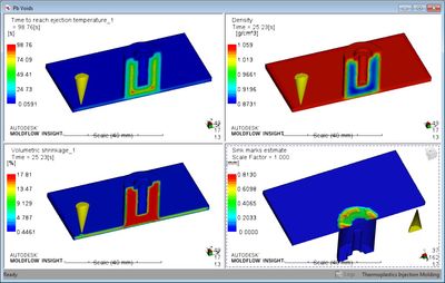

Message 8 of 10
PascalGosset
Thank you Kumar,
Then, how do you compare volumetric shrinkage / time to reach ejection temperature / density?
When do you say: a void will occur?
In my sample, can you assume if we'll have a void?
Signature: "Maybe Moldflow does not work properly, but the real world neither" my son...6 years old 😉

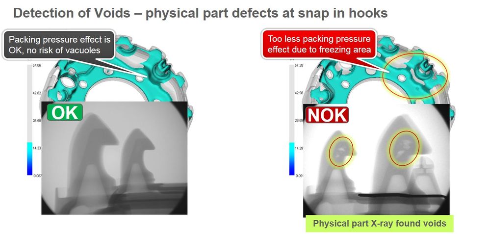

There is no direct results to measure the Void formation in the part in Moldflow. but with the help of few results we can predict there might be the chance of voids by taking few parts as benchmark.
In most of the cases if we have a part with variable thicknesses (Thick & Thin), we check whether the volumetric shrinkage is uniform or not, if we more Volumetric shrinkage in thicker section, we check how much packing that area gets considering the gate freeze time & area around that thicker section freezing that will definitely tell you where the hottest melt is. Packing plays a vital role on controlling the voids formation in thicker sections.
Key results you should see --> Volumetric Shrinkage, Time to reach ejection temperature, Temperature & packing condition.
Below is an example case study we did on controlling the voids, picture may help you what i exactly intended to explain you.
