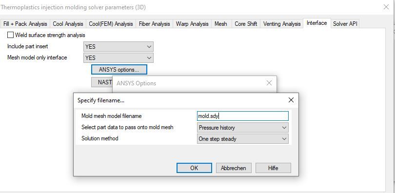

Addendum,
do not forget to copy the calculation file once and rename it e.g. to mold!
then:
and make an entry as mold.sdy
best regards
