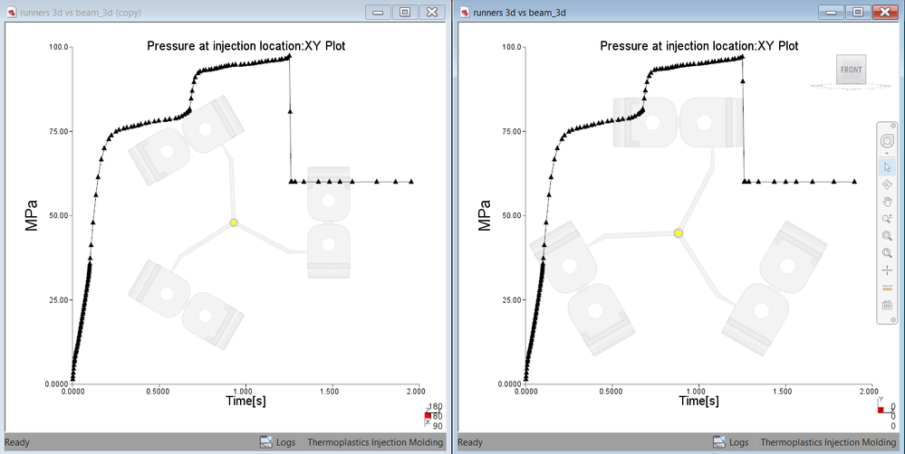

Thank you both for your contribution, unluckily the result that i obtained is almost the same.
I duplicated the study and i changed the mesh properties as you suggested.
You can see in the picture on the left the new simulation with the sprue and gate changed to cold runner properties, on the right the old simulation.
As you can see, in the injection pressure nothing has significantly changed...
I also wonder how changing the property prom part to cold runner would have done some difference in the results that i am looking for... For the pressure for exemple, the pressure fall shouldn't be related just to the geometry? (of course considering all the other parameters the same, as well as the mold temperature etc.)

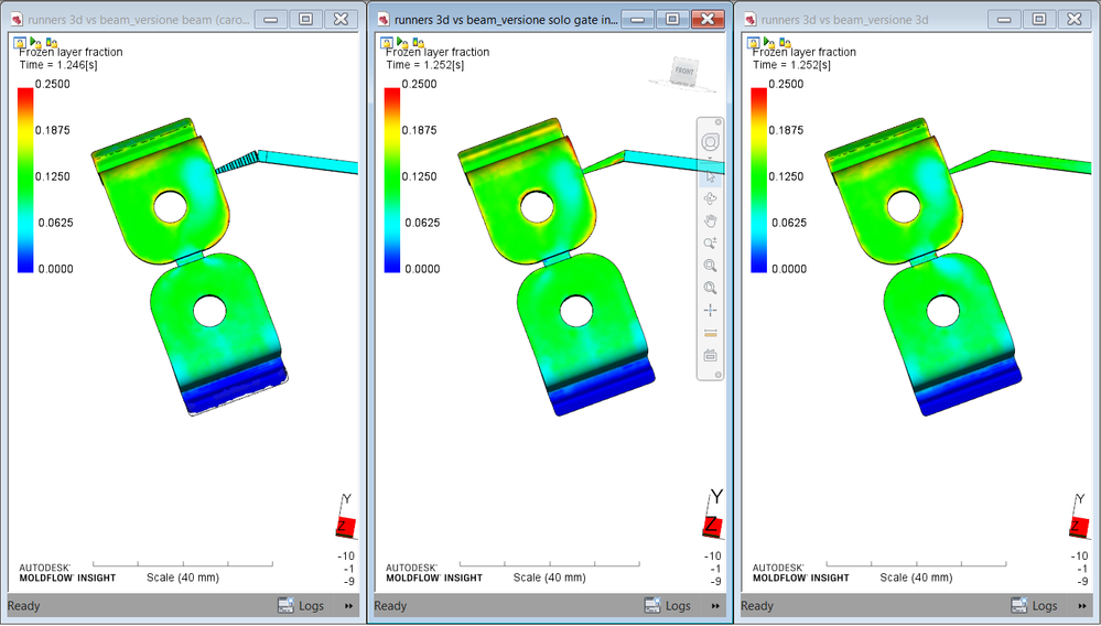

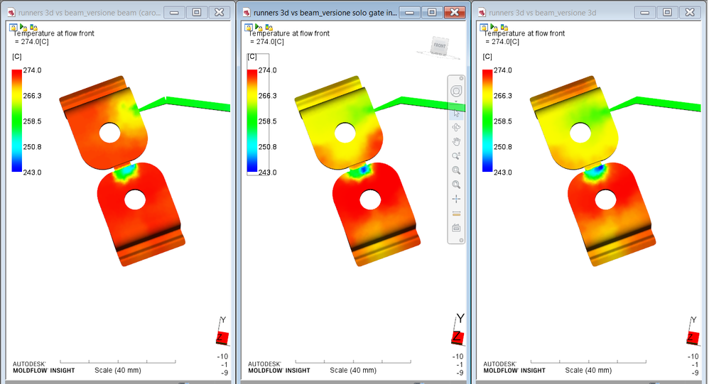

Thanks to both, starting from your observations i tried to do some more tests.
Firstly i refined the mesh at the gate for both the beams and the 3d version, then i created a "midversion" with just the submarine part of the gate modeled in 3d and the rest in beams. As you can see in the images below, the new mid-version seems to be more similar in the results with the all 3d one.
As you expected the most important role is probably played by the gate part, infact in the new version also the injection time-pressure XY plot is much more similar to the 3d version.
In the frozen layer resuslts you can see a significant difference between the 3d and the mid-3d  just in the runners part, so i wonder if maybe is really something that has to do with the way the software calculates the heat transfer?
Then i created the same injection system but using runners and gates with circular shape, in this way if the problem was the fact that the beams are always resized as a circular section with an equivalent area, i should have obtained much more similar results between the simulation with beams or 3d.
As you can see below i plotted the pressure at injection location for all these simulations. It appears to me that the difference stays the same even changing the shape of the section, so would consider that factor negligible.
Now if I want to choose the most correct one, wich one is it? If i well understand Thomas states that he would go with the midway version.

Hi everybody.
I got help from Paul of Autodesk Support to better understand what's happening. (thanks Paul)
The problem is that beams are linked to the 3d model with just one node and it doesn't matter the angle of the submarine gate and what i see graphically, the section considered by the solver for the gate is always the one given from the gate dimensions that i chose in the gate properties.
So if i have a gate like the one here below and i want the same results using beams i will need to have the final section of my beam to be equal to just the part of the section of my 3d gate wich is actually in contact with the model. So in this case the section of the beam in the final part of the gate will need to be equal to the upper part of the gate in my 3d model, the one wich is actually "touching" the part.

Did you look at the shear rate within the gates for both modelling versions?
From my experience the shear rate in gates modelled with beams is often higher than in tetra modelled gates (also very depending on the element size in the gating area).
So if it is the case in your model, this might be an explanation to the significant difference in the pressure results. As with higher shear rates the viscosity and also the pressure decreases. In addition to that the temperature increases (due to shear heating what can be seen in the temperature at flow front result, see attached picture) which leads also to a drop in viscosity and pressure.
