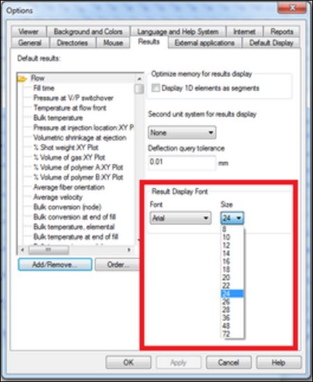

We are doing much Moldflow-Presentation for our Customers. The presentations have to look well and the font size in the legend has to be big enough to read it easily. We are not happy with this new size and would like to change it. I hope you can realize an option to edit the font AND font size in result-plots. We would prefer an USER CUSTOMIZE option to edit in all result-plots.

Frank Schaeufele demanded this improvement in June 2015. This option now exits:
To change the results font, go to: Options /Applications Options / Results / Result display font
To change the logs font, go to: Options /Applications Options / Background and Colors / Log display font
