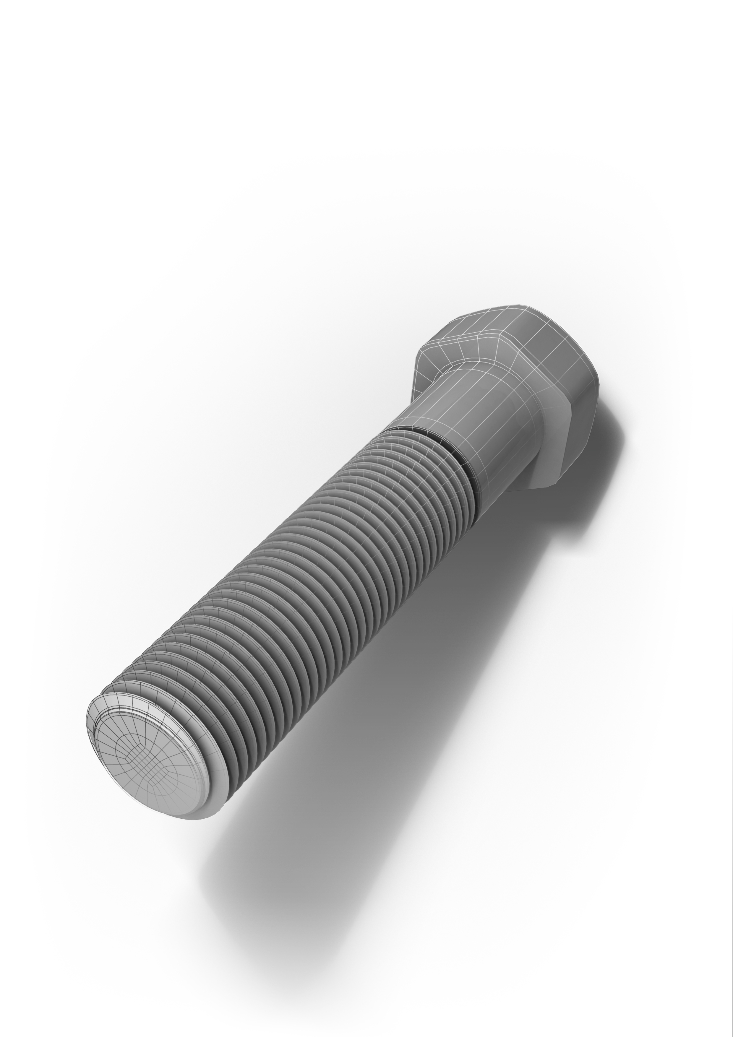

Hey folks,
im tryin to render out the smooth wireframe of a screw-model like this
screenshot
but maya render it out with subdiv like this
how can i fix this....
best Rick

ZEICHEN.TRICK
this is the vector render result
its actual that what i want but i dont believe its not possible im mental ray as wellfrontview2_wireframe.jpg

ZEICHEN.TRICK
the way it works with the vector render is
  • select and set the edges at the low poly state of your model (Create/Sets/Quick select sets)
  • after that select your model and convert smooth mesh preview to polygons (Modify/Convert/smooth mesh preview to polygons)
  • than you have to soften all edges (Normals/soften edges)
  • now you select your model and turn in the EDGE mode and go to quick select set (Edit/Quick select sets) and choose your set from the first step. Only the edges of the low poly state should be selected now
  • the selected edges from your set have to turn in to hard edges (Normals/Harden Edge)
  • open render settings choose maya vector render
  • turn of fill object in the fill options settings
  • in the Edge Options settings next the fill options are all the relevant setting which effect the look of your wireframe
  • make your settings and render
now you have a render of the smooth mesh preview wireframe that appears in your viewport after pushing 3 on your keyboard
Message 14 of 18
ZEICHEN.TRICK

ZEICHEN.TRICK
I break up testing around to make it working with MR
because afterwards has the vector render some benefits
already its always a benefit if you can change the look of parts from your animation separate...
so i can change the color of the wireframe and add some gradient...
