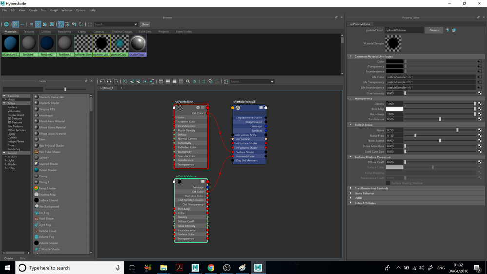

ParticleSamplerinfo node doesnt show up in hypershade? I didnt add any particle sampler info node myself but i guess that maya added this by default. When i go Hypershade-Shading Groups-Nparticle Points SE and right click on it and press Graph Network it opens only nodes that you can see on this picture. But i know that there is has to be Particle sampler info node revealed as well before Blinn and Volume because when i select my Volume node i can see some inputs in Property Editor on the right side

mspeer
Hi!
Change visible Object selection:
Right-mouse-click: Show -> ...
Silverland
Thanks. But i would save 10 minutes time if you told me to right mouse click where? (the answer is on the empty space of the hypershade) and also to choose what object?. Because randomly selecting them one by one didnt do anything, until i clicked "Clear Below" which reveals all of the nodes including light linker, render partition,particle shapes nodes (and not just particles sampler node) including the ones i dont need, so after that i hide the ones that i dont need. Thanks anyways.
mspeer
Hi!
Yes, empty space would have been helpful.
But where to click after is on you, based and what you need or want.
The easiest way would have been "Show -> Show All", or to click on the filter/search icon, but there are other options too as you now know.
