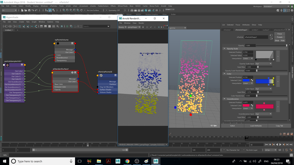

Hi! On this screenshot you can see that opacity and color AGE inputs rendering great in the Arnold render view but the Incandescence AGE doesnt (Though Emission weight set to 1.000 in AI standart surface shader)......There is a way around i found is if i Use output of the OUT COLOR (instead of OUT INCANDESCENCE)  of the PARTICLE SAMPLER INFO node and connect it to the EMISSION COLOR input of the AI standart surface but then i loose the ability have different incandescence color and different base color. MAYA FILE INCLUDED if you need it to answer

Hi!
Please read the Arnold for Maya User Guide for more details.
Simply not supported:
https://support.solidangle.com/display/A5AFMUG/Particles
