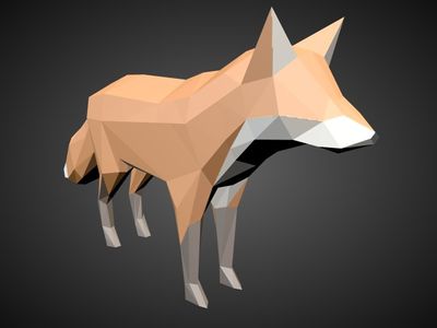

And here's an example of what I don't want:
Notice how the light and shadows show exactly where every face of the mesh is. Not subtle. Not a bad aesthetic, but not what I'm looking for.
