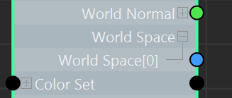

looking at Nurbs shape output attributes in maya2018, worldSpace attribute is an array.
so you may explicitly specify an index to worldspace ( ie. worldspace[0] )
connectAttr ($shapes[size($shapes)] + ".worldSpace[0]") ($nearestInfo +".inputCurve");

i edited the code with your suggestion, but this occurs when i have 2 curves selected.
// Error: line 9: The source attribute '.worldSpace[0]' cannot be found. //
