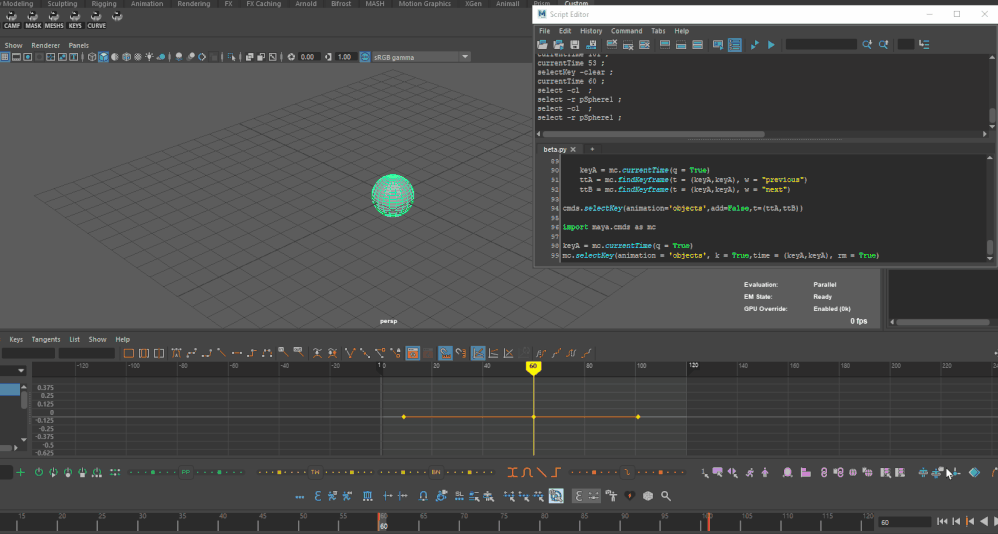

Of the keys that are selected, deselect only those that are in the current animation frame.
The code selects the current key and one before and one after the current time, I just need to deselect the one that is currently located on the timeline and I don't know how to do it.
Here is a video example of how I want it to be deselected.
keyA = mc.currentTime(q = True)
ttA = mc.findKeyframe(t = (keyA,keyA), w = "previous")
ttB = mc.findKeyframe(t = (keyA,keyA), w = "next")
cmds.selectKey(animation='objects',add=False,t=(ttA,ttB))

Hi!
You already have all the commands you need and a variable for the time you need. All you need to do is switch some flags. In cases like this, just looking up the documentation on the commands you use can help you figure stuff like this out by yourself.
https://help.autodesk.com/cloudhelp/2022/ENU/Maya-Tech-Docs/CommandsPython/selectKey.html
https://help.autodesk.com/cloudhelp/2022/ENU/Maya-Tech-Docs/CommandsPython/findKeyframe.html
https://help.autodesk.com/cloudhelp/2022/ENU/Maya-Tech-Docs/CommandsPython/currentTime.html
This is how the code you are looking for looks like when you are finished.
import maya.cmds as mc
mc.selectKey(animation = 'objects', k = True,time = (keyA,keyA), rm = True)

Before I finish the topic and accepted the solution I have a question that is related to this, and if the result that is seen on the screen the key selection I want to add the next key and the following key to the already selected?
Kahylan
curves = mc.keyframe(q= True, n = True)
for c in curves:
    kf = mc.keyframe(c,q= True, selected = True)
    prev = mc.findKeyframe(c,t = (kf[0],kf[0]), w= "previous")
    next = mc.findKeyframe(c,t = (kf[-1],kf[-1]), w= "next")
    mc.selectKey(c, t =(prev,prev), add= True)
    mc.selectKey(c, t =(next,next), add= True)
