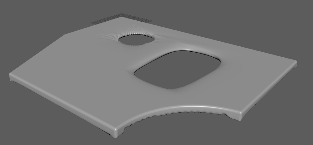

I made a model for 3D printing in Fusion 360 and it has very noticeably not-smooth circular cutouts. I thought to import it to Maya and use the Smooth function on it but all it does is add faces, it doesn't change the positions of vertexes or anything to make it look more high-detail. This function has always worked fine for me, but I've been working on this for a long time and have not gotten anything to work.
When the object is selected, it is apparent that many more faces, edges and vertexes exist after the smoothing. I have attached screenshots of the mesh selected before any changes, the mesh selected after a smooth with 2 divisions, and the mesh deselected after the smooth. It's easy to see that even after the smooth, the object has a low-poly appearance, even though the outline of the faces would show otherwise.
As stated above, the mesh was created in Fusion 360. I exported it as an STL file and imported that to Maya. I need to export this back to an STL when I'm done making it look better so I can slice it in Ultimaker Cura. Also, it is worthy of noting that I would like to know how to fix this in Maya and I don't want a fix where I would somehow make it export higher quality in Fusion or smooth it in Cura. I should note as well that the smooth previews (2 and 3 hotkeys) don't show any difference even when the model is selected.

Hello! I think what is happening here is the mesh you are importing doesn't have the vertices merged. To fix that, simply select your low resolution import, then go to Edit Mesh > Merge. (you may need to adjust the tolerance settings if it merges vertices you don't want merged). After that though, you should be able to smooth it as you would expect. Hope that helps!

Hi, osidedan! Thank you very much for the reply! I tried this solution, but it made my model look weird and I don't quite understand what's going on or how any of this works with the merging and what it does. I took more screenshots and I hope they can help you.
From my understanding with the way you described it, when I imported the STL from Fusion 360, some data relating to the vertexes was missing, but I don't quite understand it or even know if that's right. I used the Edit Mesh > Merge tool, and with different tolerances the results were different, but it gave my model a weird shape and  when I smooth the model it only gets worse. Here is what it looks like before the merge:
And after the merge, it gets these things that look like dents, and are not extremely noticeable but definitely there:
And after a smooth, the dents look like wrinkles, and they are all over the place:

the solution is very simple , your mesh is not a subdvision model , it does not have proper topology for smoothing, you need to retopo or refine to high resolution in fusion for export to printing.

The retopo tool is not gonna fix the mesh the way you need and  retopo by hand with the Quadraw tool is not gonna be easy for a beginner and you still need to understand subd topology and edge flows.
The easiest way is to finish the piece the way is meant to look like for printing in Fusion,  don’t worry too much about having a high poly model in the end. Just go on to printing the piece.

What damaggio mentioned is 100% correct, the original topology isn't really suited for smoothing. In my original response I should have clarified that I was just elaborating on why it wouldn't smooth haha.
Anywhoo, in the interest of getting this working for ya and saving a ton of work, I would just clean up the edges in Fusion, and skip Maya all together. Especially since this is going to 3D print. I've never used Fusion, but I downloaded the trial and after some tests it looks like you just need to add fillets to your edges that you want "smoothed".  Here's my quick mockup I did in Fusion of what I think you are after:

Also, a quick note, I already had the fillets on the edges, I just wanted a slightly higher poly/quality model than what Fusion exported.
