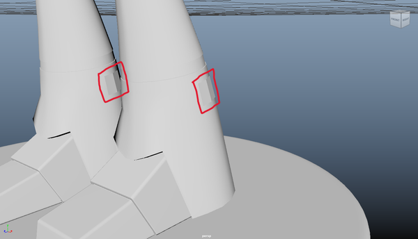

Hard topology after centering pivot, deleting history by type and freezing transformations.
AryanKumarVsp
Why does this happen & how to fix it? Please don't suggest to redo the entire model as it took me a long time to get the shapes right & I have already done UVs for the entire model.

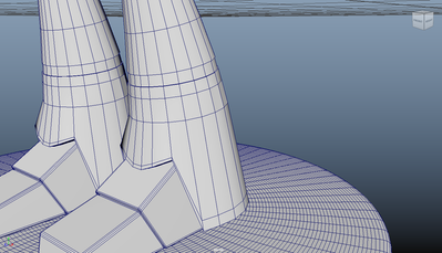

518 Views
Christoph_Schaedl
Those hard edges are there also in the first screenshot. Take a closer look why they appear.
And make them smooth if needed. Select the edges --> shift + RMB --> soft edges

AryanKumarVsp
This happens quite often on my old models, why?
Are models created on older versions of Maya more prone to this problem?
damaggio
Now that you know about normals this will never happen again and you can fix any old models if they were saved
incorrectly.
