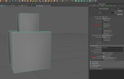

How to set model to Quad Split: Right Hand: To fix edge flow issues with Maya every asset will need this applied to it.
  • Attribute Editor "Correct" Settings: After the mesh is selected change the following settings so your mesh will match 3d Max
    • Display Triangles: Check this box so you can see the edge flow of your asset
    • Quad Split = Right: Update this drop-down from "Best Shape" to "Right"
  • Open Soften/Harden Edges Utility: After making sure "Quad Split = Right" then make sure the tool is set to "Angle = 30" and hit apply. Below is a Before and After of this operation (This is the only way I have found to update the geometry)
    • Before: Take note of what the edge orientation is of the mesh before its processed
  • After: Notice how the triangle flow flips to now be Right Hand. Your asset now matches the original FBX.
  • At this point, your asset should be set up correctly!!!
