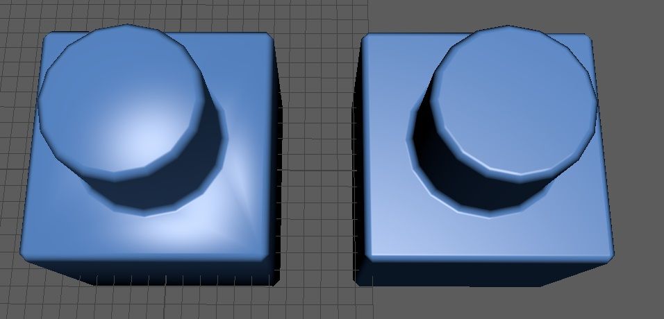

Been testing out the Face Weighted Vertex Normals approach in Maya, tested some free scripts and then tested the tools in Maya and came to the realization that if you apply a simple bevel with 1 segment and apply a soften edges on it, you will get almost perpendicular vertex normals to the faces, sometimes if the shading doesn't look right you need to do a set to faces before applying a soften edges.
In the image bellow the cube on the left is set to average and the one on the right has the method i mentioned.
Kloworks
True, but if a complex shape it will be really hard to deal with it. if you see the videos some of it require one click to fix.
