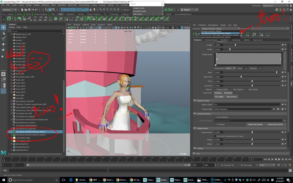

I have three characters with hair created by Xgen system. In the original file, the hair can move correctly, both dynamic curve(create by nhair) and hairs(create by Xgen) generate from the surface.  please see image correct 1,2,3
However, once I import all the three characters as reference or import directly in the my main scene file,  the hair will sink into the surface while I press play button. (the dynamic curve appear correctly)
please see image incorrect 1,2.

Message 4 of 14
you can see that the curves move same in the two scenes.But the hairs fall into the geometry.question2.PNGquestion3.PNGquestion4.PNG

this is my Character's hierarchy.I use the 'girl_master_CTL' to move the character, I donot move the hairsystem. image2
If divide them to two group like this  image 3
My final scene will get a colletion more without description. Furthermore, the hair will fall into body again. image 4
If I separate thoroughly the hairsystem from the group.like this image 5
there will two collection again, one the them without description. and there are two hairsystem in outliner. furthermore, my character cannot show the hair anymore. like image6

If I turn off the 'Trapped Check' under the nrigid. image1
But I don't know the reason.
