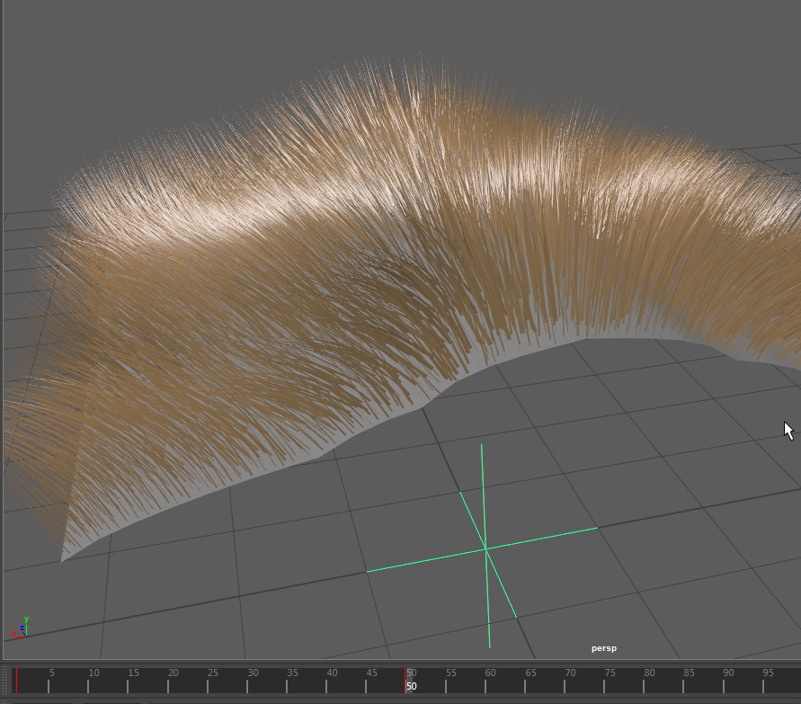

Hi everyone,
I made a ponytail in xgen with splines and want to animate the growth and noise of it.
I tried animating the primitives directly and through a Lattice deformer but neither worked.
Is there another easy solution? I don't need a physical correct hair system.
Best regards.

Whilst you can right click and key frame length values on the groom splines Length setting, it won't work as expected  as the length value is stored as a ptex map and you can't export per frame ptex maps.
The best way to animate the length value is to animate the Length Parameter in the primitives section. You can right click over the length name:
and link the parameter to a Maya attribute, in this case a float value.
This adds a Patch attribute to the geo that xgen is bound to:
$length0= patchAttr("xgen_LengthAnim_length_length0");#0.0,1.0
$length0
This attribute can be key framed by right clicking over the parameter:
With this expression:
$a=map('${DESC}/groom/length/');
$length0*$a
You can then use the key framed values as a multiplier on the groom splines control map for length. The groom splines length will not cahnge, but the renderable XGen splines length values will alter according to the set values
The Patch attribute on the geo can also be linked to other Maya node outputs, such as locators scale, so you could drive the length value with a locator in the scene if you wanted:
Cheers

Hi Sean!
Thank you very much for your reply.
Changing and keying the length parameter indeed works pretty well.
Now, is there a way I can animate the primitives, for example if I want to move the ponytail over the character's shoulder?
I saw that you can do it with a guide modifier on groomable splines which doesn't seem to exist for splines.

As for your set up currently, one thing you could is duplicate the head, hide the old head and then move the hair forwards via keying the polygon it's connected to. So the hidden head will be moving which will cause the hair to move so it will only look like the hair itself is moving.
If that doesn't help, you could also try rotating the attached polygon for the hair to sort of thrust the hairs forward over the shoulder. That combined with increasing the length modifier could work well enough.
