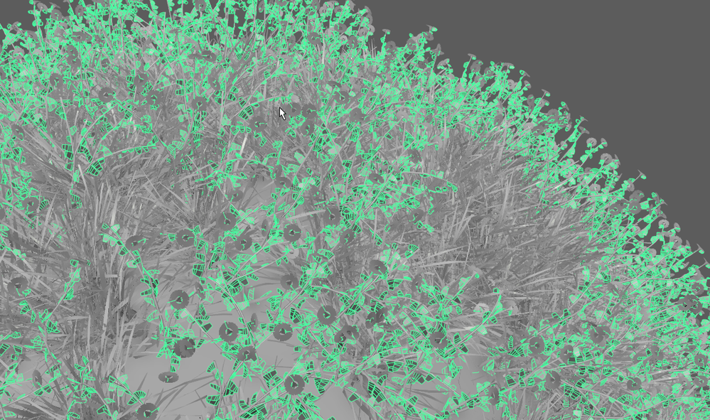

Sorry I should've clarified, what kind of object did you have set up for Xgen when doing this?
For example, in Michael Todds explanation above he has what looks like the roots to a plant. That is what is sent to the MEL file and then imported.
In your case, if you only had a handful of curves or something similar selected thats why you're seeing that when you import and that means its working as expected.
