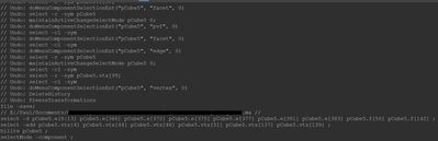

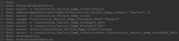

I have had this issue occur again and have documented it as best I could. Here are some screenshots showing the correct normals, the random screwed up normals, and the undo history required to reverse the issue.
Screwed up:
Correct:
Undo history from Script Editor:
So maybe something to do with Freeze Transformations and custom vertex normals?

I've had the bug happen again, and once again when I undo until it goes away it's either Freeze Transformations or Delete History that seems to be the culprit. (Or at least for some reason always what I have to undo up to in order to actually undo the bug)
This time however, i undo-ed until it corrected, and then saved my scene, after which Maya automatically selected a bunch of edge, face, and vertex components on that mesh without me doing anything except hitting ctrl+s.
I have had a hunch for a while (and this reinforces my hunch) that this all somehow has something to do with some kind of hidden pre-selections. Like the component selections of different types that are cached for that mesh are being called up when using the vert normal editing tools, so that when it looks like you have only the intended vertices selected, you then make your edit and it applies an edit to everything including those hidden pre-selections.

// Undo:
// Undo: PolygonNormalEditTool
// Undo: ConvertSelectionToVertices;selectType -ocm -alc false;selectType -ocm -polymeshVertex true;
// Undo: select -tgl -sym pCube5.f[521]
// Undo: select -r -sym pCube5.f[570]
// Undo: doMenuComponentSelectionExt("pCube5", "facet", 0)
// Undo: select -cl -sym
// Undo: select -r -sym pCube5.vtx[604]
// Undo: doMenuComponentSelectionExt("pCube5", "vertex", 0)
// Undo: symmetricModelling -e -symmetry true; if (true) SymmetrizeSelection;
// Undo: select -cl
isolateSelect -update "modelPanel4";
// Undo: DeleteHistory
isolateSelect -addSelectedObjects modelPanel4;
// Undo: isolateSelectAutoAddCallback

Okay so I just had the bug occur again, shortly after that.
It took only 14 Undo's to revert the normals this time.
I notice one common denominator in the undo stack:
- the final command to Undo in order to revert the normals back to what they should be was once again DeleteHistory.
// Undo:
// Undo: select -tgl -sym pCube5.f[32]
// Undo: select -tgl -sym pCube5.f[75]
// Undo: select -r -sym pCube5.f[74]
// Undo: ToggleIsolateSelect
// Undo: maintainActiveChangeSelectMode pCube5 0;
To be clear, the bug visually is not occurring when I delete history. It always shows up when editing vertex normals using the Vertex Normal Edit Tool. However it would seem the in order to UNDO the bug I have to go all the way back to a DeleteHistory command.
