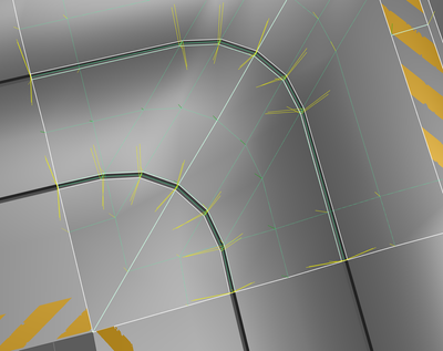

I have had this issue occur again and have documented it as best I could. Here are some screenshots showing the correct normals, the random screwed up normals, and the undo history required to reverse the issue.
Screwed up:
Correct:
Undo history from Script Editor:
So maybe something to do with Freeze Transformations and custom vertex normals?

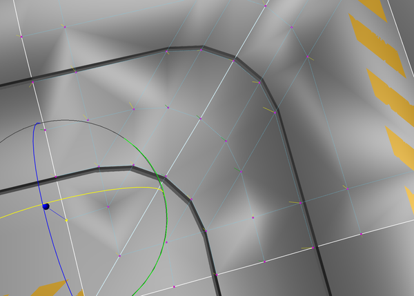

Can confirm this is annoyingly STILL HAPPENING in Maya 2025. Just downloaded it today to try, thinking surely this will have been fixed by now. Nope, didn't even get through one day of working in Maya 2025 before it happened.
Look at what it has done to the vertex normals of my model.
I had selected the vertices I wished to edit the normals of, and as soon as I touched the gizmo, all these random verts had their normals go absolutely haywire.
I can't be the only one who this is happening to.
