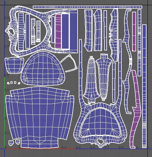

I am often finding that when I open a Maya scene that my packed UV shells will have moved position and ruined their UV layout. This issue only seems to occur on assets that a comprised of multiple separate meshes.
I do a lot of UV mapping for game assets. As part of the baking process I require that assets sometimes be separates into multiple components. The UVs of these separate meshes are laid out / packed together so that the fit within 0 - 1 UV space, as if they were one object.
The issue I am encountering is that after, painstakingly laying out the UVs for these meshes, if I close Maya and come back to work on the asset at later date, sometimes the UV shells for this geometry will have shifted position and ruined the layout.
One of the key reasons why this bug causes such problems is that my assets often utilize a lot of  shared UV space. Any changes to the UVs mean that I need to manually copy and paste the geometry with updated UVs for any place I have shared UV space. This is a HUGE pain.
I don't have a clear way to reproduce this issue but it's gotten so bad that I'm forced to try and complete the UV / baking process all in one session of Maya, just in case all the UV work is lost if I delay the bake process until a later date.
Some things that I often do as part of my workflow that might be relevant to tracking down the bug:
- I often group and un-group the meshes for export (substance painter requires meshes to be outside groups in order to use 'match by mesh name' bake functionality).
- The UV Layout operation is applied to the meshes when they are already separated from one another.
- I might combine the meshes together and then separate them again at a later date (I have not seen this cause issues during the Maya session that this is carried out though).
I am using Maya LT but have also had this issue occur in the Beta version of Maya.

Hi @sean.heasley! is this thread still open? I do have a file with this problem so maybe it could help you see. I packed the Uvs cleanly and if you re/open it you can see the they are out of place. The funny thing though is that if the file is just been opened and no other action has been made, you can select all the uv islands, move them, and undo with Ctrl+Z. This line of actions seems to put the UVs back to place.
Now Obviously this is just a workaround and sometimes, after opening a file I forget to check if the Uvs have shifted and en up having to redo them again so please, fix this.

It does work, if I fix the uvs with the Undo method I described above, then save the file, it gets fixed. The thing is that it still happens in other scenes, and after saving and closing my files I always freeze transforms and delete history. Sometimes, when I re/open the file, it is fine, Other times, the Uvs are out of place. As @Anonymous said, It is pretty difficult to replicate this bug. I just happened to have a file that had the bug.

Nope still happens.
Maya just openedMaya just openedAfter the "Move / Undo"  trick to correct itAfter the "Move / Undo" trick to correct it

Oh yeah. after doing that, the issue is fixed, even in the Maya scene. If you fix it with the Undo  trick, save, and re-open it is fixed. The problem is not that the Uvs that got messed up stay that way forever. If you fix them by hand or with the undo method and save the scene, the issue is gone. The problem is that it happens sometimes and we have now way to know when or how. Now, one thing I have noticed is:
Case 1 - If in a single maya session I model and lay out Uvs, then close the scene and I come back to it (let's say next day) and open it, the UVs are messed up.
Case 2 - If in a session I just manage to model, then save and close maya and the next day I finish the Uvs, then save and close again. When I come back to the model, the Uvs are all right.
Now with session I mean that i never cloesd maya during that work time. Also this is not always true but it is what I have experienced the most
