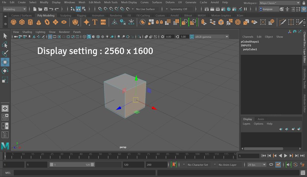

Hi, Thanks, yes my Monitor is 4k. Please find attached screen shot.

Thanks for the reply! Just for testing's sake, could you try changing it to standard resolution and start maya again? This may be a compatible issue with Maya and 4k monitors 🙂 If we can confirm that, I will get it logged with development.

Thanks it is working. I tried some thing strange! all I did as you told, changed my 4k Monitor to 2560x1600 display setting and then I opened Maya. Then I opened Maya it was working perfect having Face selection beige color. I kept opened Maya without unselecting  the same object, I went to display setting and now changed my monitor resolution to back to 4k resolution. When I checked back in Maya, Face color remained beige as needed without changing to grey color. As a final test I closed Maya and restarted computer and then opened Maya again, it works now. so all is fine and ends fine 🙂 thank you for your superb support!!
