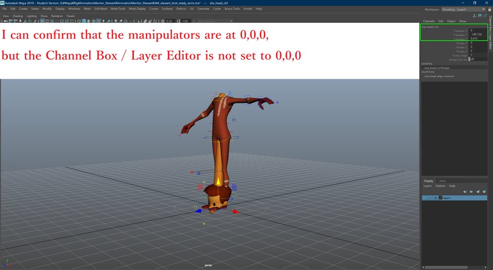

I have created a simple python command and registered it as a hotkey.
The commands are as follows
  • ResetTransform (Alt+w)
import maya.cmds as cmds
cmds.move(0, 0, 0)
  • ResetRotate (Alt+e)
cmds.rotate(0, 0, 0)
  • ResetScale (Alt+r)
cmds.scale(1, 1, 1)
This command is usually useful, but there is a problem. For example, if you want to reset the controller of your character's rig, you can use The selected controller's Transform, Rotate and Scale move to the origin.
I want to reset the values in the Channel Box/Layer Editor to 0, 0, 0.
I'll use Animation Mentor's Stewart to explain this. (Data>AnimationMentor_Stewart)
arm Rotate is not zero, so run this. its working.
cmds.rotate(0, 0, 0)​
But if you move your head and
cmds.move(0, 0, 0)​
you'll notice that Channel Box / Layer Editor is not going to zero and is moving in a weird place.
It's happening in the rig I have, so I'm sure it's happening in all rigs as well.
What part of this command should I rewrite?
9,830 Views
mcw0
The transform commands work in "spaces" ( world, local).  It's better to use "setAttr" if you want the translate, rotate and scale values to be specific.

Abdulla-Qaladzay
Hi @amaterasu-qbb
as  @mcw0    said we need to be more specific of how we want to move
in this state we need to use -ls (local space)flag or -os (object space) flag:
//mel vestion
move -ls 0 0 0;
if we do not define the space by default Maya apply the command with -ws flag(world space).
if we freeze the transform for a child object that have an offset group as parent then apply this command
move -ws 0 0 0
the offset of the parent will not work, the "head controller" must have an offset group that is why this is happen

amaterasu-qbb
Sorry for the late reply. I tried to make your mel into Python. (I don't know if that's correct, but it worked fine for me.)
#Reset transform
cmds.move(0, 0, 0, ls=True)
If you have a rig that doesn't work, I'm 100% sure with your mel.
//mel vestion
move -ls 0 0 0;
Even if I don't use setAttr, I think it's safe for the time being in my case anyway.
Thanks.
