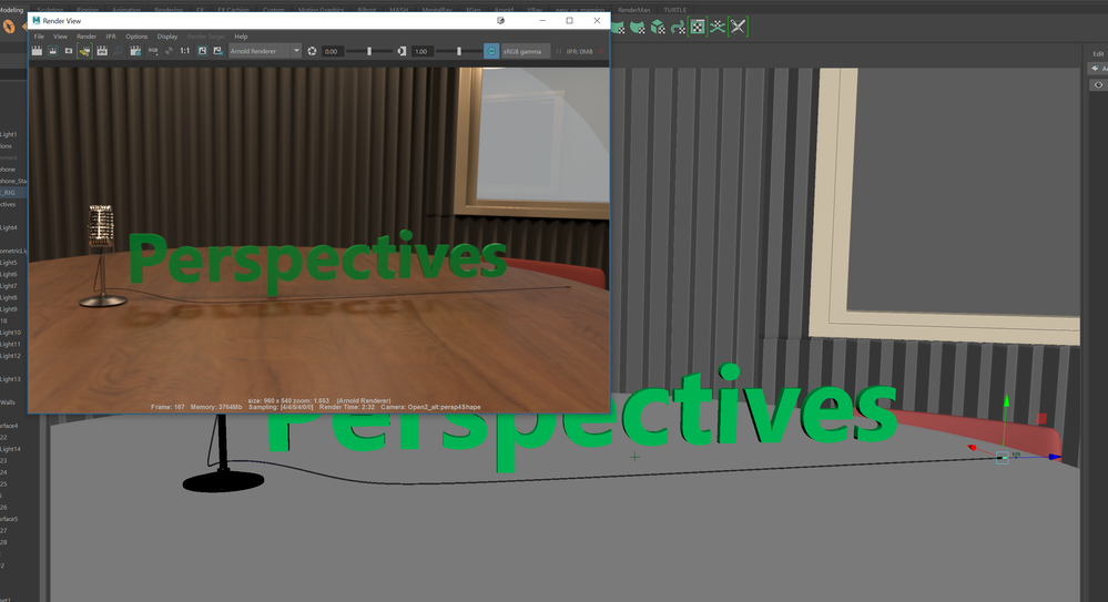

I have extruded a nurbs circle along a path in a scene to create an extending cable. I began exporting the scene yesterday. When I came back to view the render progress 17 hours later, it had only rendered 27 out of the just  over 200 frames, and the extruded nurbs circle was not even visible in the shot. Just to test, I canceled the render and rendered only the current frame, and the extruded geometry of the cable was there, but it was badly deformed and not aligned with the connector on the end of the cable. None of these artifacts are evident in the viewport
So I essentially have 2 questions here:
1) Why is the render taking so long?
2) Why does the extruded surface show up and extrude fine in the viewport, show up distorted in a single frame render, but not at all in final a sequence render?
I am at a loss.
I have attached a sample of the single frame render and the first 27 frames of the sequence render that does not show the extruded nurbs circle geometry.  I have also attached the ASCII file as well if anyone would be willing to look at it.

Also, if you scrub the timeline does the cable appear in the viewport and just not when you render or is it not appearing in the viewport either?
Message 3 of 13
Hey thanks for taking a look at it!
The cable appears and extrudes properly throughout the timeline in the viewport.
Also, doesn't Arnold only use the CPU to render and not the GPU?
Message 4 of 13
Also I forgot to mention that the cable also extrudes properly in the Arnold live renderview, but is distorted when I preform a single frame render, and is completely missing when I  preform a sequence render.

Yes Arnold is CPU based but GPU issues can cause issues like this sometimes.
I tried a sequence render as well for about 10 frames and I am able to see the cable fine so it looks like its something on your end.
A quick test you could do is to export everything as an fbx and import that into a fresh new Maya scene and see if the same issue occurs.

I don't think it's a problem of render settings or the GPU.
The problem may be caused be the changing topology of your cable.
I highly recommend to update your Maya to the latest version (and also Arnold) to see if that solves your problem.
To reduce render time lower polygon count in the scene and quality (samples) in Render Settings.

Hey, I just adjusted the scale of the NURBS circle that was extruding along the curve slightly and it seems to have worked. HOWEVER, this scene is still taking an excruciatingly long time to render (approx: 20 hours to render 15-20 frames.) I've gone through the tutorial mentioned earlier in this thread, adjusted the  samples and Ray Depth of each parameter while viewing the corresponding AOV. Nothing seems to help. People have mentioned to me that programs like Lightwave render scenes much more quickly (abeit the end product always looking like something straight out of  a late 90's/early 00's direct to VHS sci-fi film). However, every scene I've rendered with Maya so far takes anywhere from days to weeks to render. Is this just the nature of Arnold compared to other rendering engines? Is it just more advanced than Lightwave's renderer, thus takes longer? It seems to handle indirect illumination much better by comparison, but the render times are 100X longer. Would converting my smooth mesh previews to polygons help at all? There must be a more efficient way to render or even construct the scene. Please feel free to download the attached project file and critique my process. It would be greatly appreciated.
