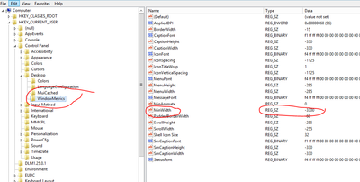

bamorim
yeah I think io found the solution
regedit :
HKEY_CURRENT_USER\Control Panel\Desktop\WindowMetrics
add the string value "MinWidth".
Change the string value named "MinWidth". Set its value using the following formula:
-15*width in pixels
try it out.
let me know if works
Message 27 of 37

Message 32 of 37
ncrossFYSVM
I used the same value as bamorim, -3300
Thanks for sharing bamorim
Message 33 of 37
halfstone
Thanks so much for posting this!  I had given up on Autodesk ever putting any time or effort into this most annoying issue - they claimed that it was a Windows issue (I guess they were right, but still ...).
I plugged in "-3300" and it worked fine, although the labels were truncated ... "Arnold Ren..." but it was enough. I changed the value to "-5000" and got a full label, but a rather long icon.  If I have a few minutes I'll change again to something like "-4000", and bet that will do the trick.
Thanks again for your generosity and your contribution to this community.
