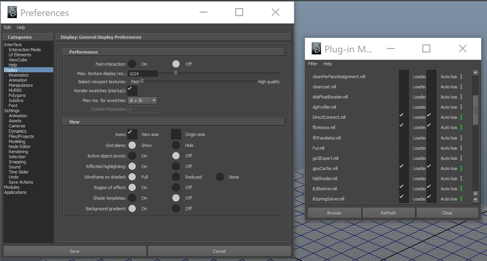

Hi Brent,
Thanks for the reply. I gave your solution a try and encountered another snag. I don't appear to have this option and the plugin is not listed in the plugin manager. Is there somewhere I can download this from or is it in a directory folder I can import into Maya?

brentmc
Ooops, I just realized you said Maya 2013 which is why you don't have the display options I mentioned.
I still think it is hardware related (so you could try different graphics card drivers) but your options are limited given how old your copy of Maya is.
