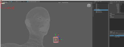

If you use "T" mode on the Display Layer, you need to see Wire, but you can't. There's a kind of gray necklace that you see on that person's neck. Although I thought I made a wrong layer and made a cube and pressed the button on the far right of the layer to insert the object, the wire was not visible in Object Mode. But in Wire Mode 4, I was able to see that it came out properly. What's the problem?

It works well in Wire mode.
But it doesn't work in Object mode (5).

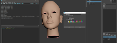

Right-click layer to open the Attributes panel and Enable override.
Or execute MEL code:
setAttr "layerName.enabled" true;
I hope this is helpful.

tjdrbrla
In the way I tried, I opened the corresponding Layer - Edit Layer window, ran the corresponding mel command in the Attribute Editor, and saved it, but nothing happened.

tjdrbrla
I think I found a solution!
That option was turned on in the settings.
I turned it off right away, so it's settled.
Sorry. I should've looked for more.
