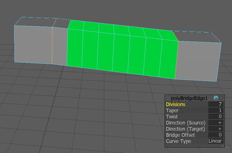

Hello, I'm using Maya 2023 and having a problem with bridge.
If I apply Bridge and add Divisions, the newly divided face's texture disappears and mesh turns green.
Re-applying the material fixes the problem temporarily but I need to reapply the material every time I bridge.
Can anyone help me fixing this problem please?
※There is no problem with Maya 2020 version. This problem only occurs in maya 2023 version.

Works correct here.

That is a logged bug and should be addressed in the next update.

no, still only works with Linear path.
Try to bridge in Bender and import back onto Maya.

I solved this issue assigning a material on the green faces. You can also select the whole object and apply an existing or new material. Hope it works for you !!

That's not a solution is the recommended workaround  , however this needs to be fixed in 2023.
