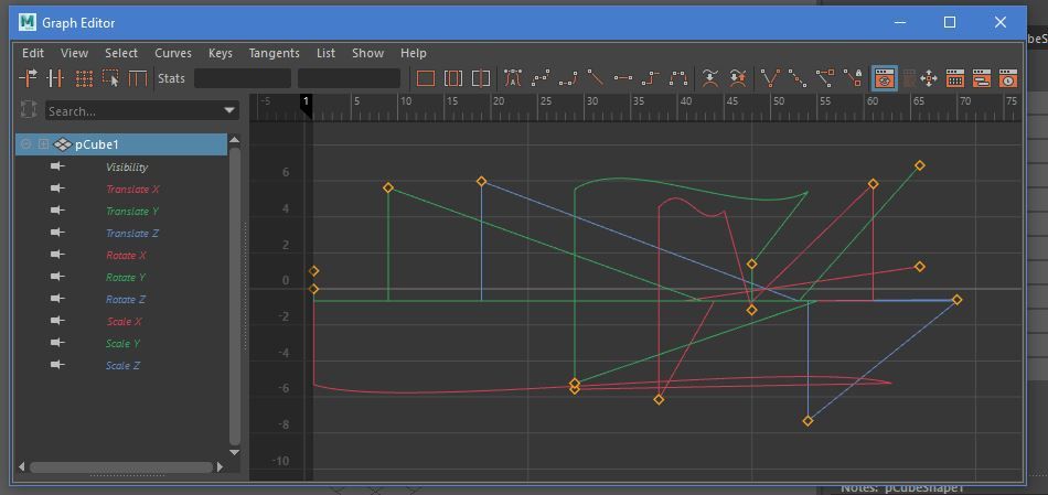

So I am a student using the student version on my computer. Apparently students don't have customer support, so I am stuck... My graph editor looks like this (see attachment) on any key. I have re-installed, installed 2 patches, rebooted my computer...all to no avail. I really need help and I don't know what to do. In 2016 my graph editor works fine, but in 2018 my lines are all over the place, creating impossible arcs. I need to edit my graph for school and make it do infinity, but because it looks like this, it throws everything off...

sean.heasley
Hi @Anonymous and welcome to the community!
Are you opening a file from 2016 in 2018? Did you save in ascii (.ma) format before opening it?
When you get a chance, can you please zip and attach the scene file here or via dropbox/google drive or another file sharing program so I can take a look at it?

Hi @sean.heasley,
I have opened a 2016 file in 2018, but this also happens when I create a brand new file and simply animate a cube translating. Below is the graph for a new file moving a cube...
Here is the link to my practice NEW file saved as both Binary and Ascii: https://drive.google.com/open?id=1taFpKbbXdB5f5APPY_a0C8cYXD8Ubw1r
Thanks!

Also, I want to note, I downloaded and installed Maya 2018 on my desktop and it is normal... It is just my Dell laptop that is doing this...

I opened it fine with no issues so it looks like it may be something with your Maya and/or your GPU.
Have you tried deleting your settings/preferences?
Also, what GPU are you using and what driver version is it?
Let me know if anything changes!

So I will be honest, I know this computer isn't the best for Maya, but it DID/still does work in 2016. I think the screenshots attached show the information about my computer and graphics card... I did delete the preferences too when I deleted everything when I uninstalled it and then reinstalled it. I don't know how to troubleshoot Maya to fix it...

Yeah this isn't the most powerful machine but like you said Maya should still be able to run.
I understand you uninstall and reinstalled Maya, but this doesn't always reset the settings/preferences so you may want to manually try deleting your settings/preferences.
Also, when you uninstalled, did you perform a clean uninstall/reinstall of Maya? If not you may want to try that.
Finally you may want to check to make sure your GPU drivers are up to date.
