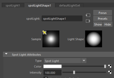

I've updated to 2018.1 and my spotlight has never worked. Attached is a test scene.
Update, I got the spotlight to work, I had to crank the intensity up to 1000000
Message 6 of 13
mspeer
Hi!
Correct, it's like in real world, for a big distance you need a lot of light (Intensity is just one of multiple Attribute to control this).

Interesting... my objects may be too large so I need a large amount of light? I’ll experiment with that, thanks. I was basing my scene scale around an object I bought on turbo squid, it is larger than I ordinarily would work at.
thanks
Message 11 of 13
mspeer
Hi!
"... my objects may be too large so I need a large amount of light..."
Yes.

Try turning on the AiRadius too, that what worked for me at first the spotlight wouldn't render only render in the default maya render engine but once I went into the Arnold tab and messed with the AiRadius. The IPR finally rendered it!
