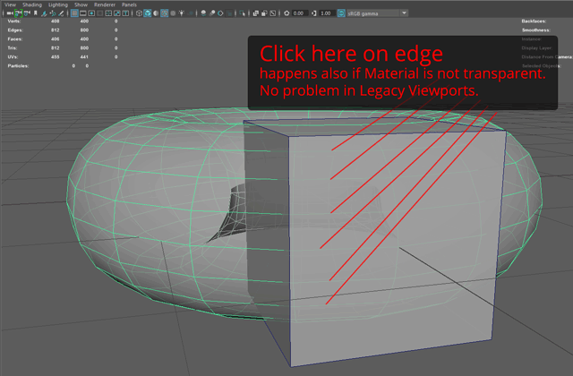

I'm having the same issue I think a lot of people are having with viewport selections using Viewport 2.0.
Sounds like this person is having similar problems as well.
https://forums.autodesk.com/t5/maya-forum/extension-2-selection-glitches-in-viewport-2-0/m-p/6973489...
Here's a pic with what's happening. The frustration compounds when I'm trying to change component modes and random unintended objects get added to the selection in face/vert/edge mode.
Camera based selection/automatic camera-based selection isn't a viable solution. I've got a lot of parts and frequently move things around to create variations and adjust components. any help is greatly appreciated. Didn't have this issue in older mayas. Legacy viewport is the best work around I've found so far.

This was reported several times and can easily be reproduced.
Viewport 2 0 sometimes react as if Shading was set to Wireframe, so when you hit an object where there is an edge of an other object behind it, the other object will be selected.
Please report this problem (bug?) to Autodesk.
Help -> Speak Back -> Report a Problem

It's easy to reproduce , just create a Torus and a Cube, move the cube over one side of the torus and ....

Hi everyone. Thank you @mspeer for the file that worked perfectly to recreate it and this is a known bug. The temporary fixes I've noticed are to change the viewport Legacy Default. Outside of that my recommendation, especially if you're working in a scene with many objects, is to have the outliner open and have all your objects named properly so you can select or deselect from there as well. I'm still looking into this as well for any other fixes/workarounds.

I did a post recently because I had the same problem, and I finally found the ULTIMATE SOLUTION !
For me and probably for you too, in your Preferences > Settings > Selection, the Default Selection Box was set around 15, I set it at 1, and now it perfectly select the element my cursor was on !
As Student Version doesn't always keep Settings for the next sessions, I hope this one will stay as I set it ..
