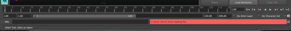

Good morning, I need some help, i downloaded maya 2015 on my mac, i tried to import dwg files from autocad 2017 by saving the file in 2010 but there is a read error, how can i do it?

At the moment Maya does not support importing dwg files. You can however export from autocad as fbx, iges or igs format and import that into Maya.
Not any more with AutoCAD 2019, Autodesk killed the FBX-import and -export function.
