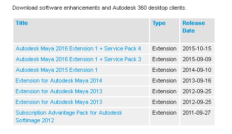

The same problem here. Maya With Softimage Maintenence.

GraphicsPB
Check the attached picture, no Extension.Smiley Frustrated
