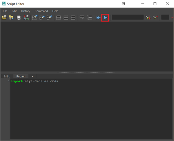

Hi @Az305 have you tried running a flush script? This command can do a decent job of clearing the memory usage.
import maya.cmds as cmds
cmds.flushUndo()
Message 3 of 15
Az305
Hi Sean,
Do you mind explaining how to do that?
Thanks.
Message 4 of 15
sean.heasley
 Select this button to open the script window
 Copy paste the first line and hit the play button (make sure Python tab is selected)
 Copy past the second line and hit play. This should flush the processes.
