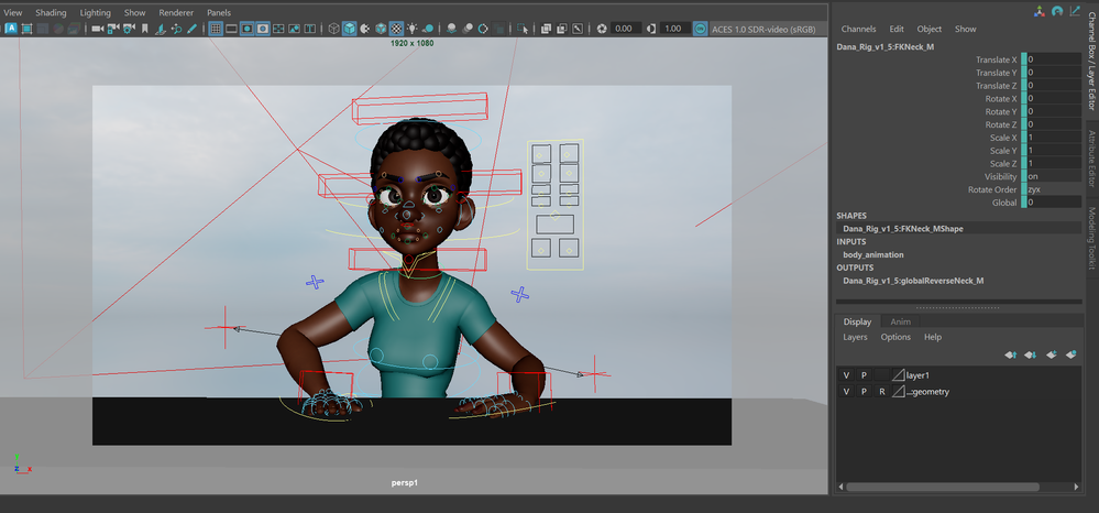

Hi, new to posting on here but I'm having a very weird issue where all of my keyframes (Maya 2024) turned blue and are now unkeyable seemingly over the span of a week? I didn't do anything to the file in that time and when I last saved it everything worked, but since then I've tried restarting Maya, breaking connections, deleting keyframes, etc. and the only thing I can actually key is the IK arm control. I've found a few other posts with others having similar problems over the years but I couldn't find any solutions that seemed to work. It also seems to have affected all previous versions I had of this file, but I haven't had issues with any other file in Maya. I also tried opening it in Maya 2022, but had the same problem. Any help would be much appreciated. Thanks!

Posting this here for anyone with the same issue in the future but I figured it out. The blue means it's keyframed on an animation layer, and if you can't edit it/key it, it's because you're on the wrong animation layer.
