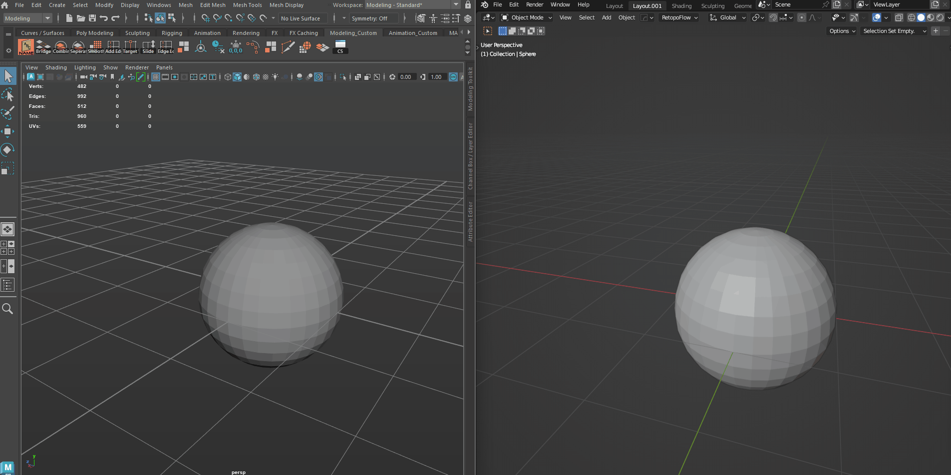

Basically the title. In Blender, the selected object only has an outline around it's silhouette which IMO makes it easier to see, so is there a way I can do it in Maya as right now it feels very cluttered? I can do a little bit of scripting too if required.

This is currently not possible.
You could change the transparency on the wireframe
https://help.autodesk.com/view/MAYAUL/2023/ENU/?guid=GUID-F7824D16-1342-4879-A669-3121D9D3582C
or disable the selection highlighting at all (per panel), but an outline for the selection is currently not an option in Maya.

Not sure if this is possible before maya 2023, but @sepu6 showed me an envvar that will make this work.
MAYA_VP2_SELECTION_INDICATOR=4

shanemL33YK
You can not do it at runtime. You need to either set it globally before launching maya, or put it in your maya.env file located in
C:\Users\<USER>\Documents\maya\<VERSION>\Maya.env
You would want to add a new line to that file (if pre-existing content) and add:

It seems to be working, but now I am unable to see the edges/faces in the component mode and I have to toggle wireframe on shaded to view them, but I guess that's the limitation of this.

I had changed my selection colors from Windows -> Settings/Preferences -> Color Settings, and for the thickness of the outline, I think that's because I have anti-aliasing turned on in the viewport
