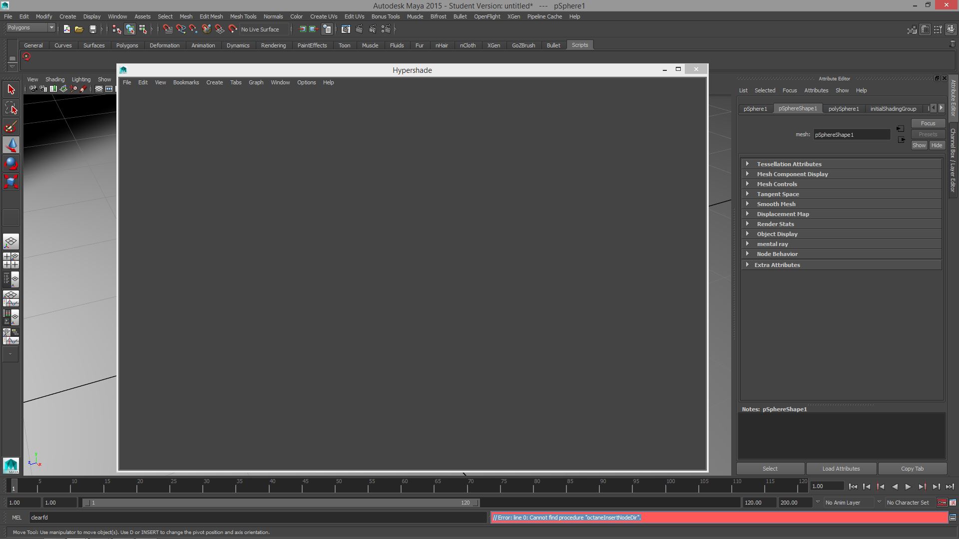

Hypershade panel has NOTHING in it...
I reinstalled twise FYI...
Console shows one error when opening the hypershade panel.
// Error: line 0: Cannot find procedure "octaneInsertNodeDir".
Watdahell is wrong and how do I fix???

When I try to assign a material to anything this error shows...
// Error: file: C:/Program Files/Autodesk/Maya2015/scripts/others/renderCreateBarUI.mel line 626: Object '' not found.
I would like to mention again that I have fully uninstalled EVERYTHING autodesk/maya then reinstalled maya TWISE.

I FIGURED IT OUT! Smiley Very Happy
For people who care to know or have the same issue...
Just go to the maya folder in your documents find the prefs folder, rename it something, and maya will create a new one, effectively resting to default, the hypershade and related bugs will then work.

Hi fothers1,
Did you hit the octane error or the renderCreateBarUI one, or both?
I'm also curious if this post about octane fixed the issue for you:
http://render.otoy.com/forum/viewtopic.php?f=28&t=41696#p226840
If not, it's worth checking if there are any other hyperShadePanel or hyperShade mel files in any of the paths included in your Maya 2016 MAYA_SCRIPT_PATH. You can find out all the folders in that path by typing: getenv MAYA_SCRIPT_PATH
Ryan

I only had one instance of a hyperShade mel being in my global script location, which I deleted, then the hypershade worked.  I have not used octane, so cant really coment about that.
Thanks.

go to: "...\Documents\maya\2015-x64\prefs" open userPrefs.mel with wordpad, search for Octane and delete the lines.
just it.
Message 13 of 13
in reply to: Anonymous
I tried finding the Octane line in the UserPrefs.mel file......But cannot locate it on the Mac OSX
Is the method for resetting the hypershade on Mac different??
