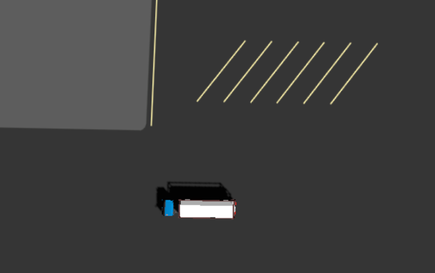

Hi, this is what I have rendered, but not what I want. I still want the truck with shadow. I don't want the road texture and I want it to be an alpha. But the thing is, the shadow is on road texture layer. If I turn off the road texture layer, the shadow will disappear.
sean.heasley
Hi @Anonymous
If you disable "Primary Visibility" in the Render Stats an object will not be rendered, it still can generate shadows, reflections and refractions on other objects but it will not receive them. So if you turn the visibility of your shadow-plane off you will not get any shadows on the plane.
You should enable "Primary Visibility" on the plane and you could use the "useBackground" shader on the plane so it will appear transparent but still have the shadows cast on it.

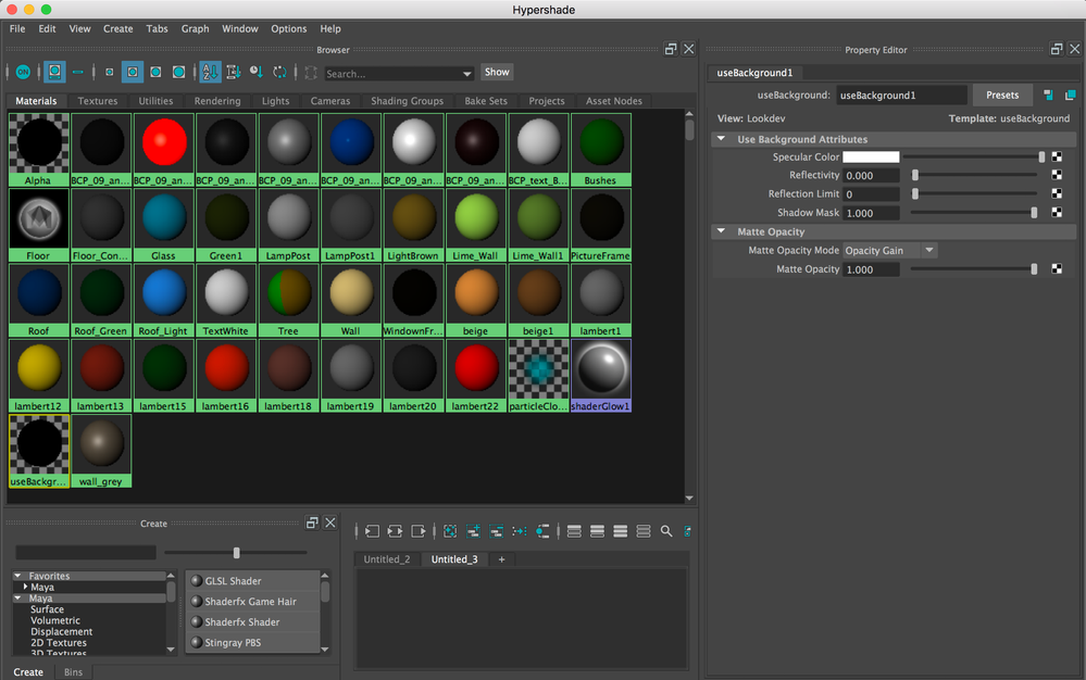

Hi, I can't render Arnold, but I found a solution.
What I did, at 'nurbsPlane2' (object) in main window > right click > Assign Favourite Material or Assign New Material > Use Background.
Then, I rendered as Maya Hardware 2.0. It works!
So, I can use back the previous background just right click at 'nurbsPlane2' > Assign Existing Material > choose Floor (material that I used before).
Thanks for your help.
