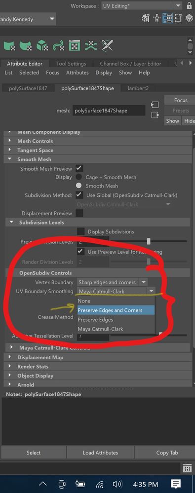

Is there a way to change the default OpenSubdiv> UV Boundary Smoothing from Maya Catmull-Clark to Preserve Edges and Corners. In 5 years I've never used anything except Preserve Edges and Corners, and I'm just getting tired having to change it for every piece of geometry, thank you.

I think you might be out of luck. I don't even think you can adjust the mel script for the create commands to do this.
Your best bet is just to make a toolbar button to set all objects in your scene to use the uvSubdiv method you want.
Attached is a super quick (and kinda dumb) way of doing so in python (i have not tested it in python 3... should still work).
Sorry I couldn't give you a better answer, good luck.
