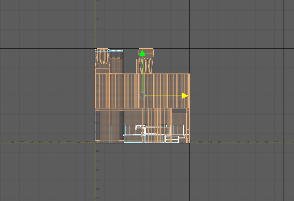

This is Uvs for two different texture overlaying on each otherThis is Uvs for two different texture overlaying on each otherThese are separate according to two different textures; one for bridge and one for street lightsThese are separate according to two different textures; one for bridge and one for street lights3.PNG4.PNG5.PNGthese are two different materials for assigning two different texturesthese are two different materials for assigning two different textures

If you have everything combined, which it looks like you do, you can delete the other UV sets as you should only need the one that has the UVs and then just place them how you like them. You can also keep the UVs overlayed as they are, but you will just need to apply the different textures to the right spots.
You won't be able to have one texture cover this whole scene because there's too much UV overlap you would need to have at least 2 textures, for example on texture could be the bricks and cement while another would be the street lights.
