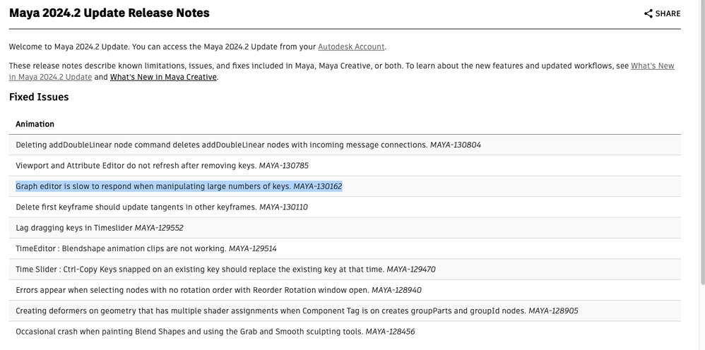

Well.. I guess I wasn't just imagining things after all.. Maya 2024.2 came with a fix for this issue, let's see if it improved?
"Graph editor is slow to respond when manipulating large numbers of keys. MAYA-130162"

its Maya 2024.2 - issue is here... nothing is fixed

It is not fixed in Maya 2025, the graph editor is once again super slow sluggish. I cant work this way!
