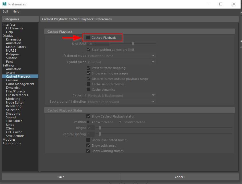

In the past few days i have working on a project with n particles and rigs involved...I have been facing
1) performance issue---maya has an 'on  off 'delayed opening into an empty scene. And the performance is also                                                      unpredictable.
                                           I have reset preferences...did a fresh reinstall...nothing works.
                                           Its in completely updated 2020 version.
2) CPU rendering-----I have been trying to arnold render particles with cpu render sequence.
                                       It does 99% of first frame in sequence and freezes maya. I have to force out of maya.
                                        It render normally with render current frame. But sequence it freezes.
                                        I have  turned off  autothread in render settings. But to no use.

Thanks for posting this question. Regarding the Rendering issues, can you please enable the Arnold Log File in Maya and send it to me: How to get an Arnold .log file in Maya
Regarding the performance issues, can you please try to Disable Cached Playback in Maya:
Looking forward to your feedback, if Disabling Cached Playback helps to solve the performance issues.

Hi
I had disabled cached playback but it didn't work.
Regarding rendering issues i changed evaluation mode to parallel and rendering engine to direct DX 11....It worked for now.
