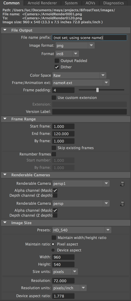

I'm running Maya 2018 Student Version in osX High Sierra 10.13.1 and I get the following error:
// Error: file: /Applications/Autodesk/maya2018/Maya.app/Contents/scripts/others/renderSequence.mel line 151: AssertionError: file /Applications/Autodesk/maya2018/Maya.app/Contents/Frameworks/Python.framework/Versions/Current/lib/python2.7/site-packages/maya/app/renderSetup/model/localOverride.py line 112: Should not create an ExportListener instance without Render Setup instance. //
My Render Settings look like this, and rendering one frame works well.
Screen Shot 2018-02-12 at 00.48.51.pngScreen Shot 2018-02-12 at 00.49.07.png

Hey, same problem. But when I reset Maya the same error continues. Any solution? Thank you!
@Anonymous wrote:
Okay, solved it following this https://knowledge.autodesk.com/support/maya/troubleshooting/caas/sfdcarticles/sfdcarticles/Error-file-C-Program-Files-Autodesk-Maya2018-scripts-others-renderSequence-mel-in-Maya-2018.html
